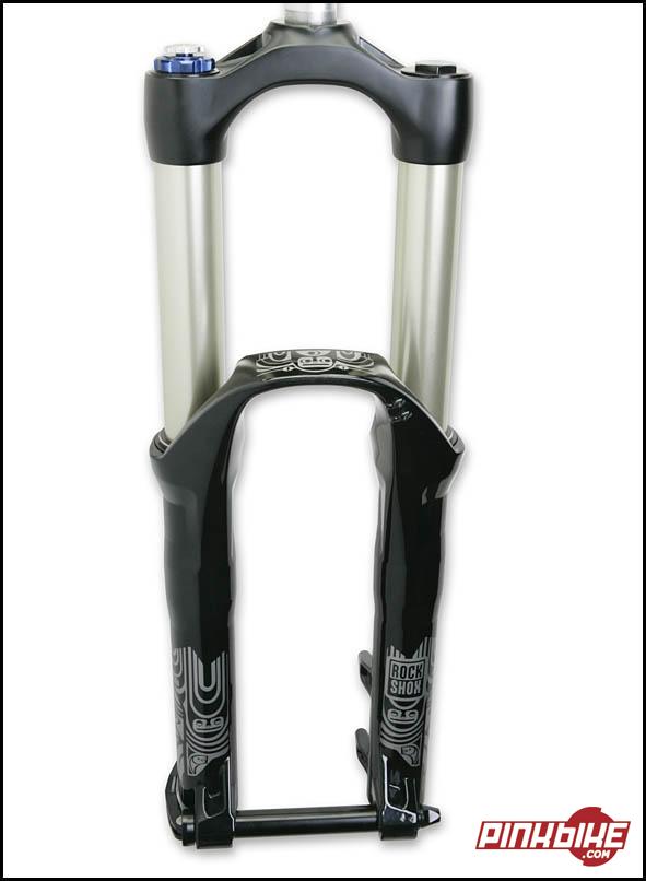

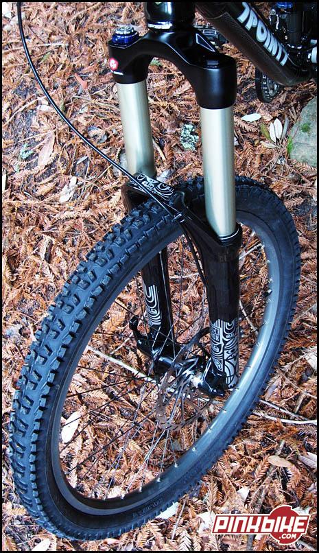

The Totem is a 180mm single crown Freeride (or should I say black diamond ;o) fork with 40mm taper wall 7000 series aluminum stanchions and colossal magnesium lower casting - this bad boy redefines the term “burly”!! So burly in fact that RockShox uses the term power bulges when referring to those massive bulges on each side of the lower casting.

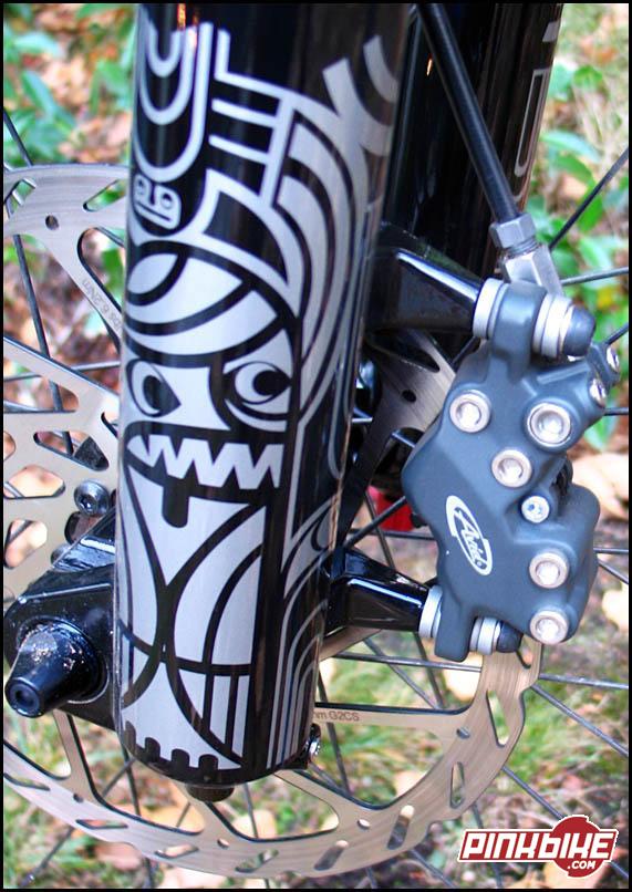

Forged 66-TV aluminum crown, aluminum 1.5" or 1 1/8" steerer tube, post disc mount (203 min rotor and 210 max), 20mm Maxle 360, galvanized or glossy black colors and SpeedLube ports pretty much tops off the long list of Totem features.
Post Mount with 203mm Avid Code

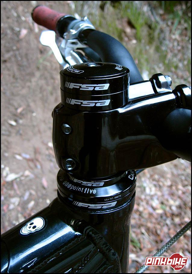

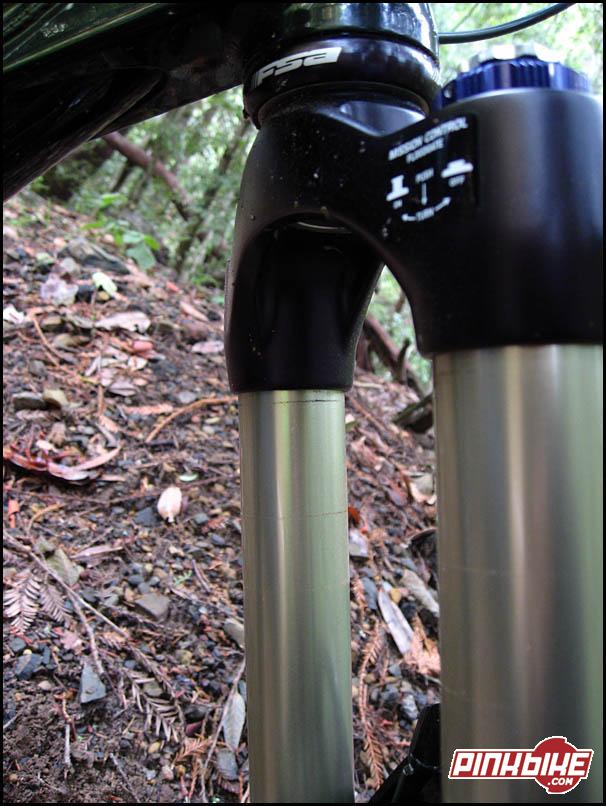

One thing you should keep in mind before purchasing one of these long travel single crown fork is the bike it’s going on and what headset setup you plan on running. Depending on the combo you run, the Mission Control adjustment knobs might hit your downtube in certain settings.
Hello - my middle name is "burly"

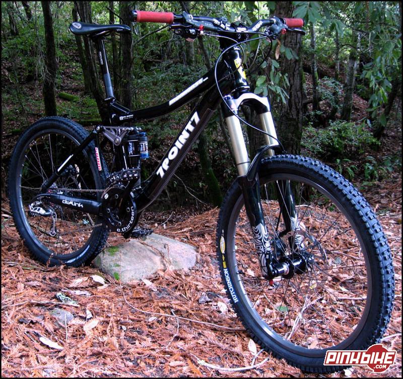

I know a lot of you out there like to keep that front end low – so you’re thinking “I’ll just get the 1 1/8 fork and run zero stack reducer cups”. Well in many cases this setup will make contact with the downtube. In my case, the Totem was going on an Iron Horse 7Point7, which features a 1.5 headtube. My options were 1 1/8 with a standard headset or 1.5 with headset cups. The 1.5 version is lighter, 20% stiffer under bending, which is fore and aft movement and 10% stiffer torsionally than the 1 1/8th version. The choice was easy.
When I purchased my Iron Horse 7Point7 last year, it came with a 1.5 headset. I never ended up using it since I ran e.thirteen zero stack reducers and a BoXXer WC – so in the spare parts bin it went! The day I got the Totem I went and dug out the 1.5 headset out of my spare parts bin and proceeded with the install. Unfortunately, only after I’d pressed in the headset that I realized it was an FSA Orbit Extreme Pro 1.5R (R stands for reducer).
Thinking I needed to buy a new headset I called FSA up. To make a long story short – the FSA Orbit Extreme Pro 1.5 can be run both ways by swapping out a few small parts. Nice to have the option of running either a 1.5 or 1 1/8 using the same headset.
Installing a 1.5 fork when there are no 1.5 tools available (e.g. Crown race setter, Star nut setter, cutting guide) can be an interesting challenge. Especially for a guy that like me who likes to use the proper tools to get the job done. To set the crown race I could have used a hammer and screwdriver – but instead I made my own 1.5 crown race setter with a big metal pipe and big 1.5 washer, which I had to dremel a bit. The star nut I simply eyeballed and I made a cutting guide using some drill press vices.

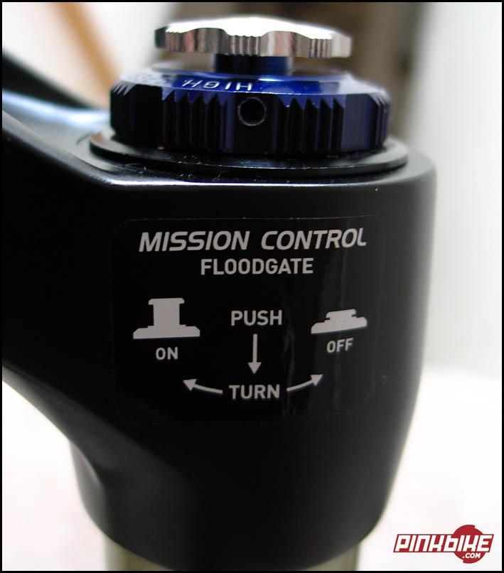

Although I don’t use it often, I would like to point out that the floodgate works great – especially for long sustained climbs. I also have to comment on the stiffness of the Totem, it’s as stiff, if not stiffer than my 06 WC BoXXer – amazing!
